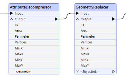

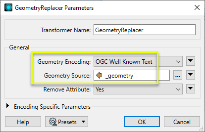

In this portion of a workspace, data with a geometry attribute that was previously compressed by the AttributeCompressor has been read, and needs to be used. The compressed data is contained in the _geometry attribute, and was originally encoded as OGC Well Known Text (WKT).
After reading the features, they are passed to the AttributeDecompressor for interpretation. The compressed attribute is selected, and there is no encryption. Character encoding is set to fme-system.
At this point, the geometry is still an attribute, but has been decompressed and is readable. The next step is to use a GeometryReplacer to create the geometry, which can now be used elsewhere in the workspace.
