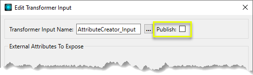

Disabling Published Input
When you want to set a number of iterations as a transformer's parameter, you might want to connect the Loop to another input port. In this case, this input port should not receive any external input features. To do this, click the properties button of the input port to open the Edit Transformer Input dialog. Beside the custom transformer name, unclick the Publish checkbox.
Unpublished input ports can be recognized by a small "lock" icon:
