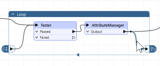

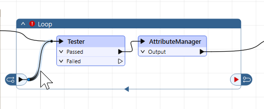

  2. Create a connection from the input port of the first transformer in the loop to the loop output port in the lower left corner of the loop block.
  3. Create a connection from the output port of the last transformer in the loop to the loop input port in the lower right corner of the loop block.
