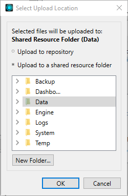

    • Upload to repository: The files associated with the resource are uploaded to the repository you specified in the Publish to FME Flow dialog. The files are available only to workspaces in the same repository.
    • Upload to a shared resource folder: The files associated with the resource are uploaded to a shared resource folder that is preconfigured in FME Flow. This is the preferred location for storing data files for use in FME Flow. Files in shared resource folders are available to all workspaces on the FME Flow, regardless of repository.
    • Specify the shared resource folder in which to place the files. The Data folder, or any of its subfolders you may have created in FME Flow, is the preferred location.
      To create a new subfolder in which to upload the files, select an existing folder and click New Folder.
      Click OK to close the Select Upload Location dialog.
