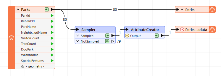

This example workspace shows the canvas with generated caches after a workspace is run with data caching enabled:
To view cached features, click a cache icon on an output port. Complete caches are available to view after a translation runs successfully. Caches can also be viewed while a translation is still running. While running, all cache previews are refreshed each time an additional cache is selected for viewing.
