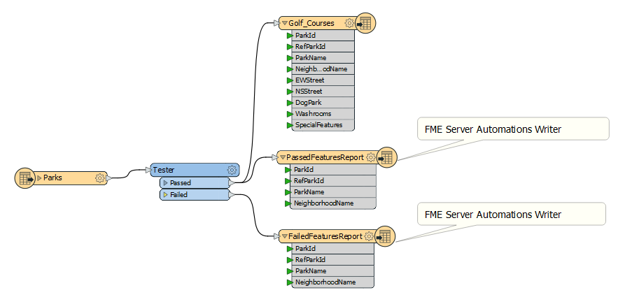

For example, consider a workflow that receives emails and runs a workspace, which performs some sort of validation on attached files from the emails. Features in the attachment that pass validation are read into a database. With the addition of FME Flow Automations writers, you can configure the workflow to send messages on the results of the validation, including details on feature type attributes. You can send one message about features that passed validation and were read into the database, and another message about features that failed validation. In the workspace, these messages correspond to the output written to two Automations writers, as seen here:

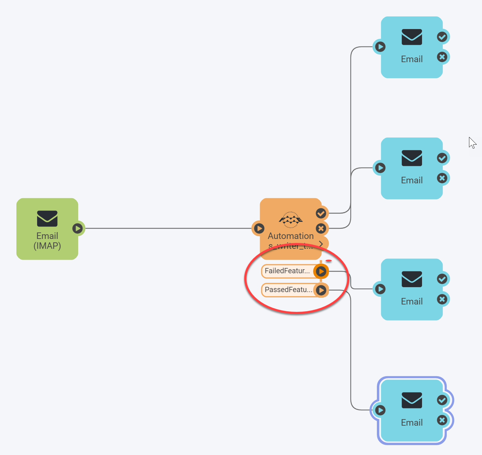

When the workspace is uploaded to FME Flow and referenced in a Run a Workspace action of an Automations workflow, it looks like this:
Mouse-over to view screenshot:
Notice that the Run a Workspace action has two additional output ports (circled). The name of each additional output port matches the name of its corresponding feature type, as defined by the FME Flow Automations writers. (Also notice that, in addition to the messages sent from these additional ports, the workflow sends messages based only on whether the workspace runs successfully or not.)

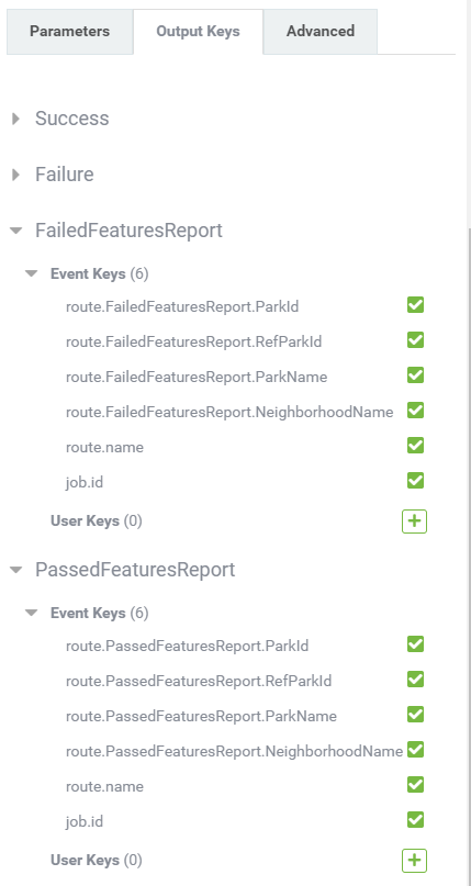

The two additional ports output JSON-formatted output attributes that correspond to the feature type attributes exposed in the writers:
These attributes are available as Workspace parameters in downstream components of the workflow.
