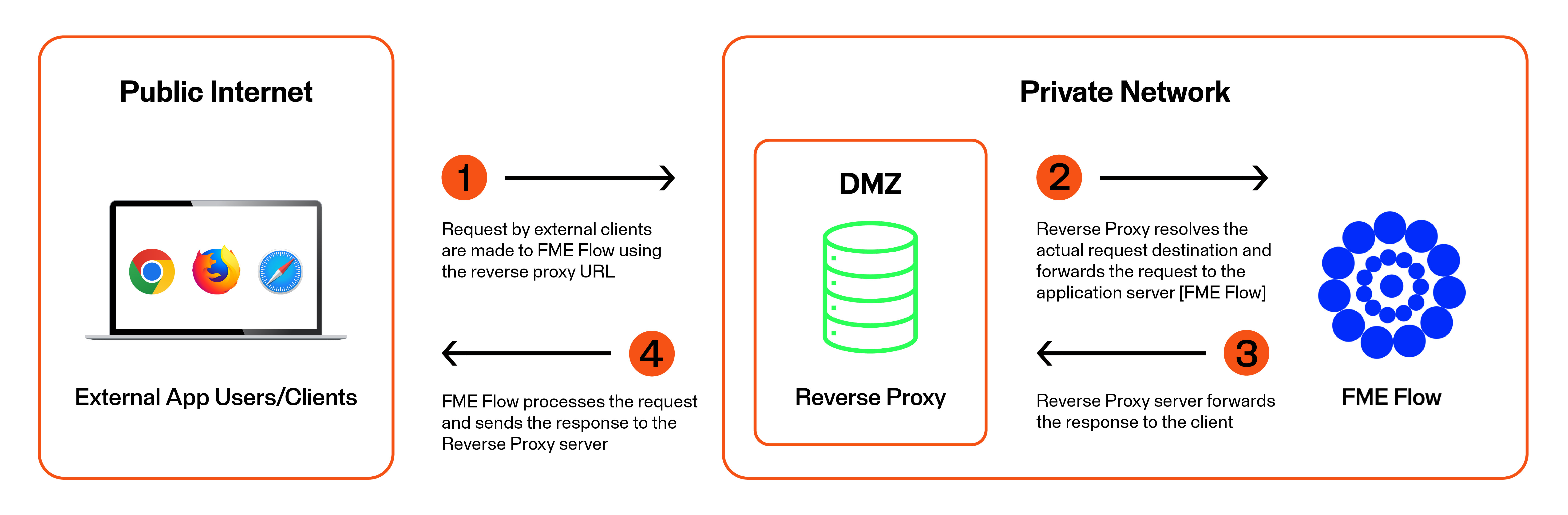

A reverse proxy forwards requests from the internet or intranet to a server that fulfills the requests. Often a reverse proxy configured with SSL provides a secure entry point into a network through a DMZ.

- Route two-way traffic between the FME Flow Core, FME Flow Web Services, and the reverse proxy. Configure a redirect/rewrite so that all URLs matching the following patterns are forwarded to FME Flow:
- /fme*/
- /api/
- For more information see Routing Traffic to FME Flow.
