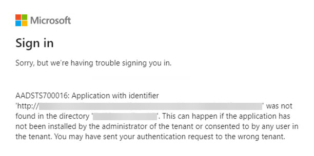

When logging in to FME Flow with credentials from a SAML identity provider, authentication fails with a message similar to the following:
This issue may occur on Distributed installations of FME Flow that use an Apache Tomcat web application server, and connect to a SAML identity provider through a reverse proxy.
