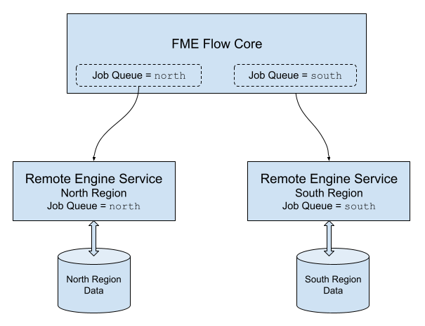

To ensure each job is run by the intended engine, you must use either approach in combination with Queue Control.
In this Remote Engines Service example, consider two data sources - one located in a northern region, and another located in a southern region. To run jobs efficiently, it makes sense to access remote engines in both regions. Jobs that are run on queue north access data in the northern data store. These jobs are routed to remote engines located in the northern region. Likewise, jobs that are run on queue south access data in the southern data store. These jobs are routed to remote engines located in the southern region.
