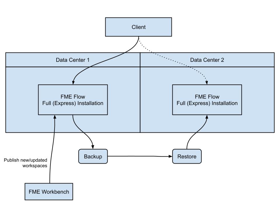

This example of disaster recovery is a combination of an Express installation and a fault-tolerant installation. However, instead of a third-party load balancer between systems, FME Flow clients must be manually redirected to the FME Flow Core host server of the second data center in the event of a disaster. Each data center houses full ("Express") installations of FME Flow, essentially configured to provide similar functionality. To ensure synchronicity of FME Flow system data between data centers, Backup & Restore operations are performed regularly. (Otherwise, workspaces and other updates must be published twice - to the FME Flow Core hosts on each data center.)
Keep in mind that when planning for disaster recovery, all clients of FME Flow, including web browsers, the FME Flow CLI, and the FME Flow REST API, must connect to the "active" FME Flow Core host.
