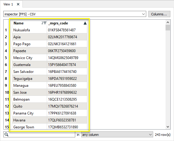

In this example, we have a CSV file of cities with associated MGRS codes. They have no geometry.
The features are routed into an MGRSToLatLongConverter.

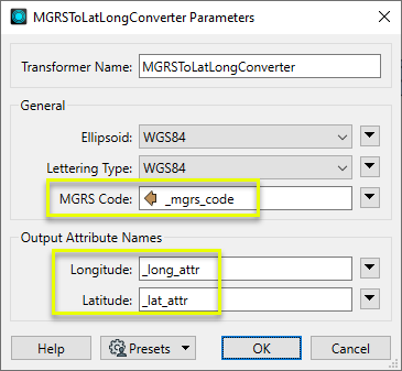

In the parameters dialog, MGRS Code is set to the appropriate attribute. Default attribute names are kept for the coordinates output.

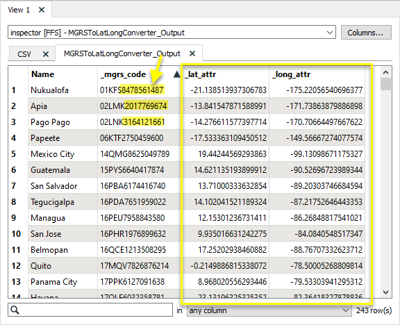

The output features now have attributes containing latitude and longitude coordinates representing the center of the area described by each MGRS code.
Note that in this case, that area is 1 meter square, as the MGRS codes have a precision of 5.

Ellipsoid |
The ellipsoid used for the conversion. This can be any ellipsoid name supported by FME. |
Lettering Type |
Select a type:
MGRS Code |
Supply an MGRS code by providing an attribute name, expression, or user parameter. |
Longitude |
Name the attribute to contain the generated longitude value. |
Latitude |
Name the attribute to contain the generated latitude value. |
