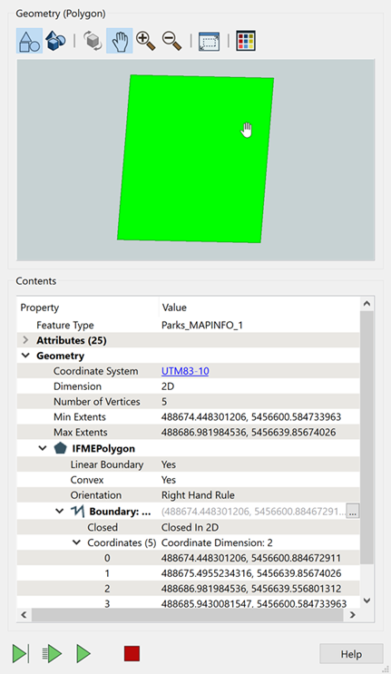

This Breakpoint Inspector window displays when you run a translation with breakpoint inspection enabled. It contains a viewer, information on the feature's properties, and processing control buttons.
Viewer
The viewing area displays features for verification and debugging purposes. When the Breakpoint Inspector stops at an inspection point, the feature will appear in the viewer. You can perform basic zoom-in and zoom-out functions, pan the area, and change the background color. In this example, the background has been changed from the default.
You can also rotate (Orbit Mode) three-dimensional features.
Note  The Breakpoint Inspector does not render Textures, Rasters, or Point Clouds.
Contents
Exposed and Unexposed Attributes
Displays all the attributes and attribute values of the feature.
For more information, see Understanding Feature Types and Attributes.
Geometry
Displays all the geometry information for the feature, including the name of the FME Geometry Type to which the feature belongs.
Shown here are:
  • Coordinate system (if applicable)
  • Dimension (2D or 3D)
  • Number of vertices
  • Local coordinates of the bounding box (or cube in a 3D dataset) of the currently selected feature
  • A full listing of all geometric information for the feature (coordinates for all geometry types, information about measures, transformation matrixes, raster bands, and so on).
Control Buttons
Step the translation to the next link, whether or not it is a designated breakpoint.
Step the translation to the next breakpoint.
Continue translation without stopping.
Stop translation. Pressing this button will clear the Feature Inspection window. You can restart it by pressing the button.
