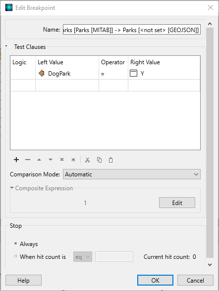

By default, the Breakpoint Inspector stops at every breakpoint that you define but you can also set inspection parameters so it will stop only when certain conditions are met.
To display the Breakpoint Parameters dialog, right-click on a defined breakpoint and select Edit Breakpoint:
This is the default name that the Breakpoint Inspector assigns to the breakpoint. You can rename any breakpoint.
Check this box to define test clauses for the breakpoint.

- Always
- A hit is registered every time a condition is met. Enter a number in the text box, and the Breakpoint Inspector will stop only when the hit count is equal to, less than, greater than, or a multiple of that number.
The current hit count is shown on the right.
