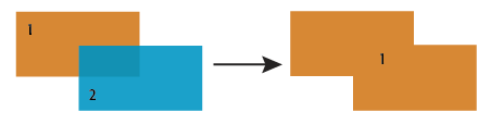

Detects coplanar regions of input surfaces and dissolves them into single faces. The output faces retain the attributes, traits, and appearances of the input.
All surfaces are broken down into faces. For example, a mesh is broken into faces, one face per mesh part. Non-surface input features are not supported.
Example:
Surface features.
Surface features are output here.
