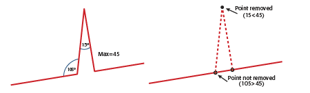

The SpikeRemover receives features with line, path, or area geometry and removes vertices that create angles less than or equal to a specified maximum between zero (0) and 180 degrees.
Spikes can be removed either in a single pass through the feature or iteratively, where new spikes created by spike removal are also removed until none remain.

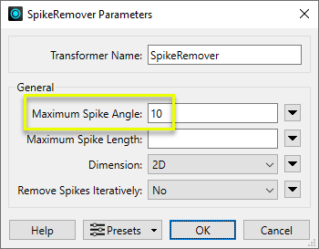

The feature is routed into a SpikeRemover. In the parameters dialog, Maximum Spike Angle is set to 10 degrees.

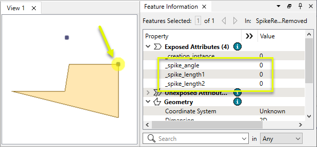

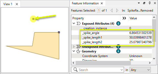

The smaller of the two spikes falls under the maximum, and so its central vertex is removed. The removed vertex is output via the Removed port and receives new attributes indicating angle and length.
Note a second vertex with an angle and length of zero (0). This was a consecutive duplicate vertex, which has also been removed but does not affect the shape of the output geometry.

When Remove Spikes Iteratively is No, these attributes are added:
- _spike_angle
- _spike_length1
- _spike_length2

Maximum Spike Angle |
Specify the maximum angle in degrees between two line segments to be considered a spike. The value must be between 0 and 180 degrees. |
