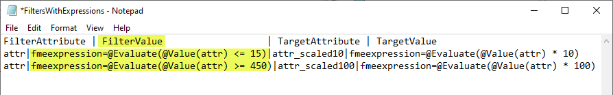

Filtering
This example lookup table will filter features based on the value of the attribute attr. If:
less than or equal to 15, or
greater than or equal to 450
the feature is considered mapped and is passed to the next Action (or output via the Mapped port, if there are no further actions).

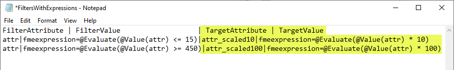

Adding Attributes
Using the same example lookup table, if the action is Set New Attributes, features will receive two new attributes - attr_scaled10 and attr_scaled100, both with values calculated by expressions.
