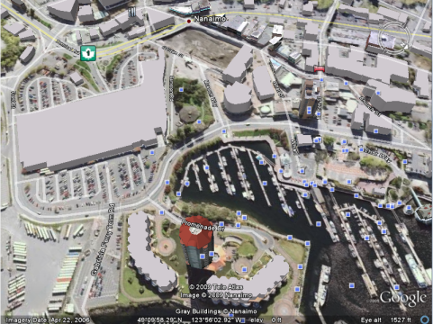

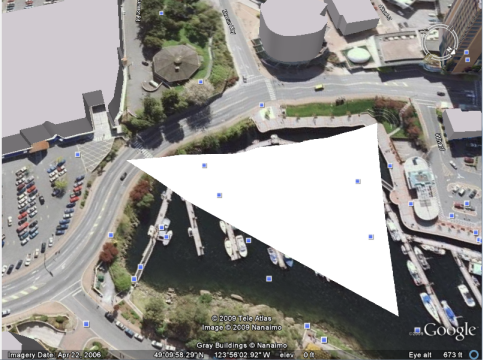

The default settings will calculate a bounding box, and use that as the bounding box for the feature's region.
The inactive view shows that the feature is not initially displayed when you are zoomed out. The region is "inactive" and therefore the feature is not shown.
As you zoom in closer, the view meets the display criteria and the region activates; that is, the feature displays.
