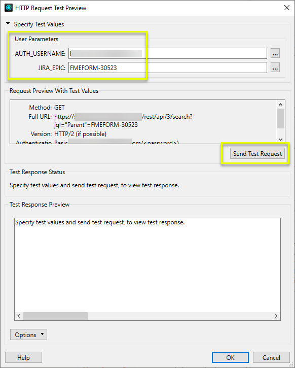

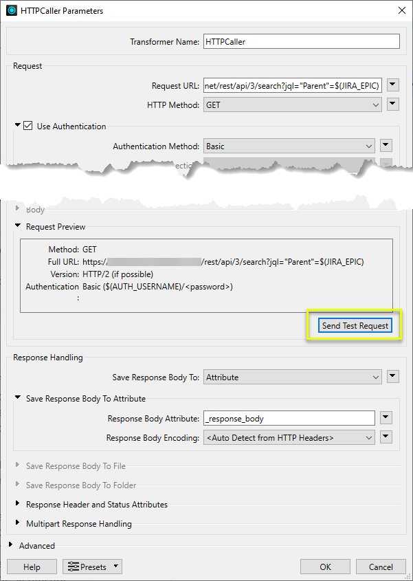

In this example, we are configuring an HTTPCaller to access Jira using the GET method.
To test the configuration, we use Send Test Request.
In the Test Request dialog, note that the user parameters used for configuration are available and populated. To test the configuration, use Send Test Request.

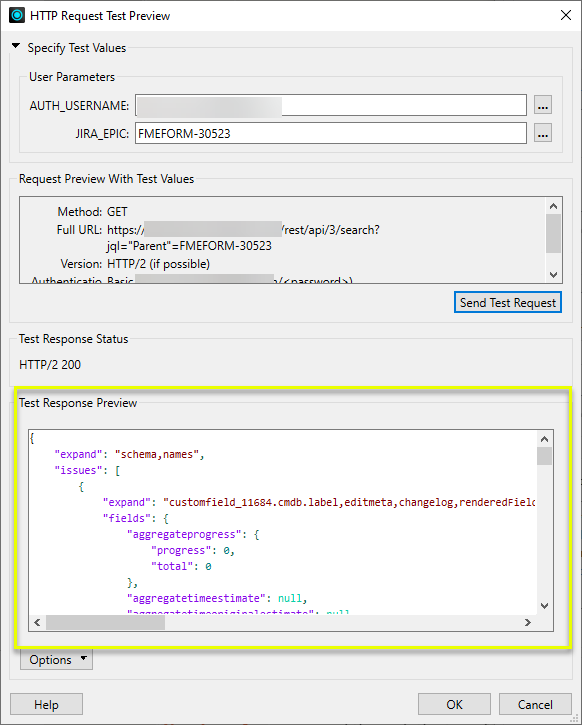

The returned results are presented in Test Response Preview.
Further testing can be done by changing the user parameter values, but these values are for testing only and will not be applied as actual values in the workspace.
Clicking OK will save the current response and any user parameter values for future reference.
