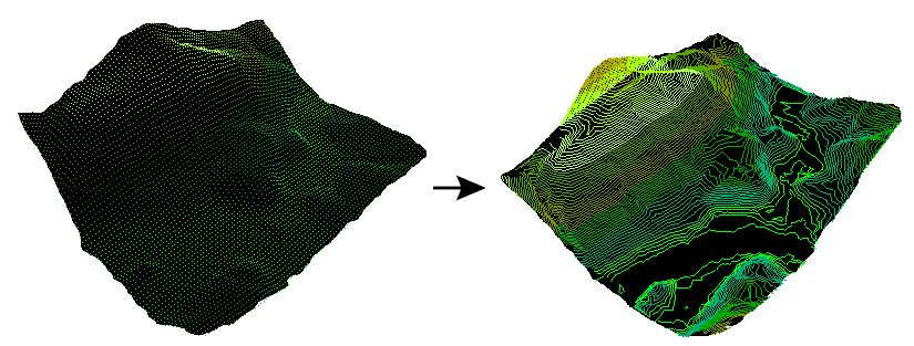

ContourGenerator
Constructs a Delaunay triangulation based on input points and breaklines. Contour lines are then generated from the triangulation.
Example
