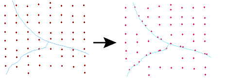

AnchoredSnapper
Brings lines, segments, end points or vertex points of features together if they are within a certain distance of each other, where one set of features is non-moving.
The difference between the AnchoredSnapper and the Snapper is that anchor features are considered to be accurate and consequently do not move.
