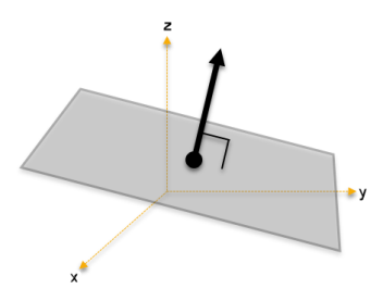

Normal Vectors
The normal vector is perpendicular to the slicing plane and indicates its orientation.
For use in this transformer, it is defined in two parts - a point on the plane, and a vector relative to that point. Both parts consist of x, y, z values.
The point on the plane is an absolute position in 3D space, and the vector values are added to those coordinates.
The vector's magnitude (length) is irrelevant for this operation - the vector values can be any distance along the normal vector. The ratio of x:y:z describes the vector's direction.
