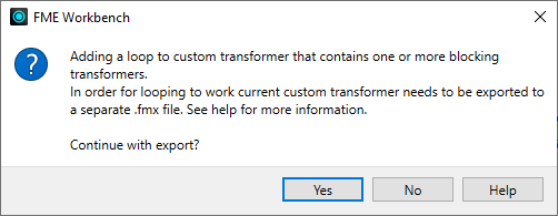

  2. Alternatively, when you add a loop port to a custom transformer that contains a blocking transformer, FME prompts you to export the custom transformer, and displays the following message:
    Note   This message does not display if you add a blocking transformer to a custom transformer that contains a loop port. However, you can still export the custom transformer.

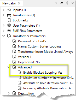

  3. Open the linked custom transformer (.fmx file) in FME Workbench. In the Navigator, under Transformer Parameters > Advanced, set Enable Blocked Looping to Yes.
  4. Note  Only one LOOP is allowed when "Enable Blocked Looping" is set to Yes.

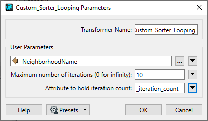

    When "Blocked Looping" is enabled in a linked custom transformer, two additional parameters are exposed on the transformer: Maximum number of iterations and Attribute to hold iteration count:
    These two parameters control how many times the loop is to be executed and help prevent infinite looping.
