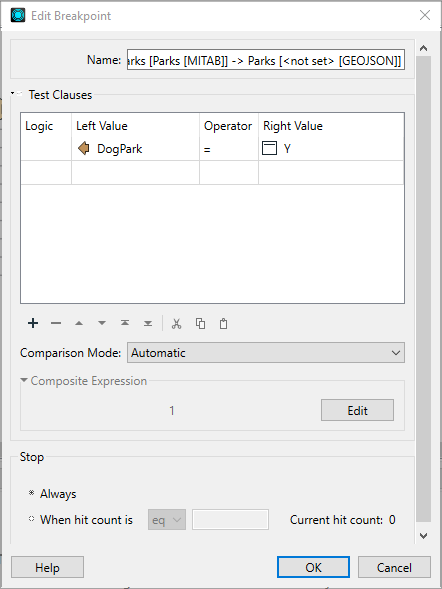

By default, the Breakpoint Inspector stops at every breakpoint that you define but you can also set inspection parameters so it will stop only when certain conditions are met.
To display the Breakpoint Parameters dialog, right-click on a defined breakpoint and select Edit Breakpoint:
This is the default name that the Breakpoint Inspector assigns to the breakpoint. You can rename any breakpoint.
Check this box to define test clauses for the breakpoint.

Negate
A checkbox indicating that the test should return false if the test expression is true and vice versa.
For example,
X=abcd, is 'abcde' Contains X if negated (answer no = Failed)
X=5, Y=1,2,3,4 is X In Y if negated (answer yes = Passed)
Mode
When Mode is set to Automatic or Numeric, the filter will compare operands as numbers if possible, and as strings otherwise.
When Mode is set to Case Sensitive, the filter will compare operands as strings using a case sensitive comparison, and will not attempt numeric conversions.
When Mode is set to Case Insensitive, the filter will compare operands as strings using a case insensitive comparison, and will not attempt numeric conversions.
When Mode is set to Date/Time, the Tester will compare operands as FME Date/Time values if possible. If the input data is not in FME Date format, the comparison will be done as string and an attribute, fme_expression_warnings{} will be added to the feature to indicate this was done.
For a string that can be represented as a number such as 4.5 or 4e5, if you set Mode to Automatic or Numeric, it will be treated as a number if the other operand is also representable as a number.
For example, if Mode is set to Automatic or Numeric, “4E5=400000” will pass the test. If, on the other hand, you want “4E5=400000” to fail the test, set Mode to Case Sensitive or Case Insensitive.
For example, if Mode is set to Date/Time, “20180109141824.9024787-08:00=20180109131824.9024787-09:00” will pass the test.
The Pass Criteria defines how multiple clauses are interpreted in the final classification of the incoming feature. The possible choices are: Any Test (OR), All Tests (AND), and Composite Test.
Here are descriptions of the three choices, and relevant scenarios.
Scenario | Pass Criteria | Description |
If any test passes, the input feature will be classified as Passed. | Any Test (OR) | In this case, as long as one of the test clauses is true, then the feature is Passed. This is an OR test (test1 OR test2 OR test3). If any one is true, then the result is true. |
All tests must pass for the input feature to be classified as Passed. | All Tests (AND) |
This is stricter than Any Test (OR) because all tests must be true in order for the result to be true (test1 AND test2 AND test3). |
Create your own test expression. This is useful when you need fine-grained control over when you want the Breakpoint Inspector to stop. |
Composite Test |
If, for example, you want to check whether the value of an attribute is between 5 and 10, or equals 99, you can set up three test expressions: Clause 1 : x > 5 Clause 2 : x < 10 Clause 3 : x = 99 (where x is the selected attribute in the Left Value field):
To correctly get the desired results, you require that clause 1 AND clause 2 be true (between 5 and 10), OR clause 3 be true (equals 99). In this case, choosing Any Test or All Tests modes will not satisfy the test requirement. You can, however, choose Composite Test and enter the following expression in the Composite Test field: ((1 AND 2) OR 3) The numbers above correspond to the test clauses defined in the Test Clauses table. When read, the composite expression above states that Clause 1 AND Clause 2 must be true, OR Clause 3 must be true. |
The expression to be used when the Pass Criteria parameter is Composite Test. The expression can refer to a clause in the Test Clauses table using that clause's row number.
- Always
- A hit is registered every time a condition is met. Enter a number in the text box, and the Breakpoint Inspector will stop only when the hit count is equal to, less than, greater than, or a multiple of that number.
The current hit count is shown on the right.
