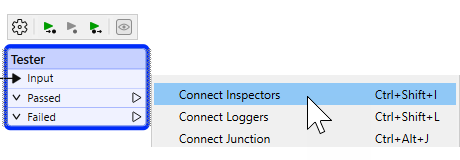

Right-click on an output port in a Transformer, and select Connect Inspector.
This connects an Inspector transformer directly to the output port, and names it according to the output port. Through the properties button, you can further distinguish between Inspectors by setting unique pen and fill colors. Enable and disable individual Inspectors by right-clicking and selecting Disable Transformer from the command menu.
Tip  To remove Inspector transformers quickly from the Workspace, use Run > Remove > Inspectors.
