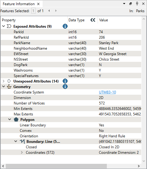

Information about the feature(s) displays in the Record Information window.
If multiple features are selected, the feature whose information is currently displayed in the Record Information window is highlighted.
Clicking the arrow beside a section name expands/collapses the information in that section.
Raster datasets display additional information that includes row/column, location, band and palette properties, and palette keys and values.

Exposed and Unexposed Attributes
This section displays all the attributes and attribute values of the currently selected feature.
For more information, see Understanding Feature Types and Attributes.
Geometry
This section displays all the geometry information for the currently selected feature, including the name of the FME Geometry Type to which the feature belongs.
Shown here are:
  • The local coordinates of the bounding box (or cube in a 3D dataset) of the currently selected feature
  • A full listing of all geometric information for the feature (coordinates for all geometry types, information about measures, transformation matrixes, raster bands, and so on).
Coordinate System: Displays the coordinate system of the selected feature, or Unknown if the format does not support coordinate systems. Click the link to display detailed information about the coordinate system:
This area also contains information about whether the feature is 2D or 3D, the number of vertices in the feature, and minimum and maximum bounding box values of the selected area.

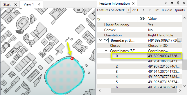

Tip  If you click on the coordinates of a point listed in the geometry section of the Information window, the point is marked in the View window. You can also choose to display coordinates and text insertion points in the View window.
