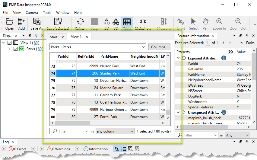

In addition to 2D or 3D view modes, you can view attribute data for features in table format. When either 2D or 3D view mode is active, the Table View appears outside of the View window, in another part of the interface (as long as it is selected in the View menu, under Windows). To replace the 2D or 3D data in the View Window with the Table View, click the Table View icon () on the toolbar, or press Ctrl+1 on your keyboard. The Table View appears directly in the View Window:
Alternatively, when not in Table View mode, you can drag and dock the Table View to another part of the interface, or as a separate window.
The Table View displays data for a selected feature type. To switch between feature types, for each dataset, use the Table drop-down selector above the table.

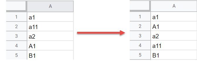

To sort table data, click on the header of the desired sort column. The last column header that is clicked becomes the primary sort column, the second-to-last becomes the secondary sort column, and the third-to-last becomes the tertiary sort column. You can sort on a maximum of three columns. Click a column header again to change the sort order from ascending to descending. Right click on a column header to specify a sort order or to specify that a column be sorted on either its alphabetical or numeric properties. To clear all sorting, right click on any column header and select Clear All Sorting.
Note  Unless Sort Alphabetical or Sort Numerical is explicitly specified, sorting is Natural. That is, FME Data Inspector sorts according to the values in the column, rather than the column data type. The following example shows how a column containing a mix of letters and numbers is sorted in ascending order (Sort Natural Ascending):
