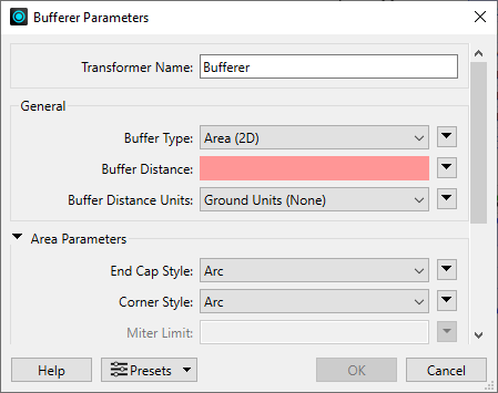

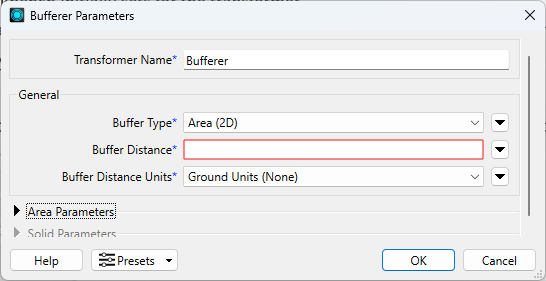

In many cases, you can use the transformer without changing the default values; however, sometimes you will need to perform an action before you can use the transformer. In these cases, the transformer parameter will be outlined in red, as shown in the Buffer Distance parameter below:
