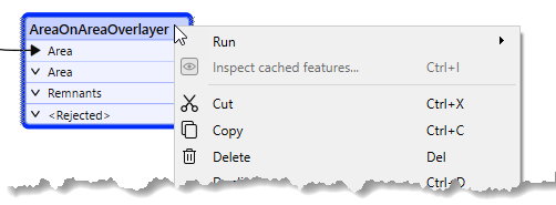

Right-click on a Transformer, and choose an option from the command menu.
Cut, Copy, Delete, Duplicate
Performs these functions on the selected transformer.
Rename
Type a new name and press Enter.
Disable
Disables the transformer. Menu selection changes to Enable when the transformer has been disabled.
Hide Connection(s)
Hides the connections to and from the transformer. Menu selection changes to Show Connection(s) when connections are hidden.
Connect Inspectors
Connects Inspector transformers.
Connect Loggers
Connects Logger transformers.
Connect Junction
Connects a Junction to all output ports of a transformer. Alternatively, right-click on a single output port and select Insert Junction.
Attach Annotation
Add a comment associated with this transformer.
Show Summary Annotation
Shows hidden object information. This can be useful when printing a workspace.
Create Custom Transformer
Creates a custom transformer from one or more selected transformers.
Auto Connect
Creates destination feature types and connects them to each output port of the transformer.
Bring to Front, Send to Back
Useful if you have a large workspace, with many objects.
Zoom to Transformer
Zooms and focuses the canvas on the selected transformer.
Inspect
Applies only to transformers that connect to a database, and displays the data in the FME Data Inspector.
This option is also available as an icon shortcut () above the transformer when it is selected.
Open Containing Folder
Applies only to transformers that connect to a database, and opens a Windows Explorer window showing the location of the source data.
Help
Opens the Transformer Help.
Properties
Rename the transformer, or view or edit the transformer parameters. (This is the same as clicking the parameters button on the top right-hand side of the transformer.)
