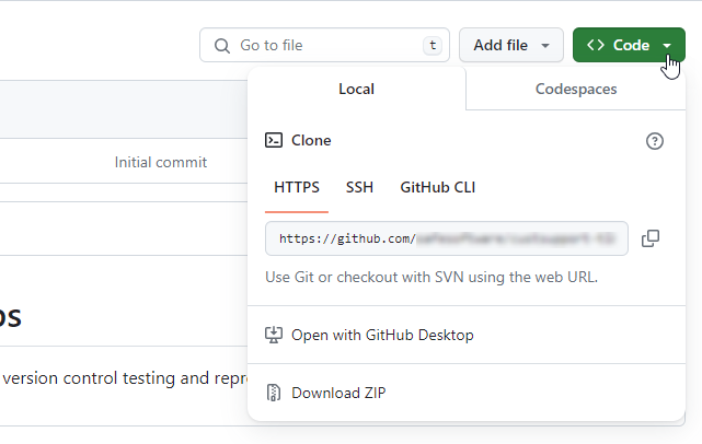

    • The Remote Repository URL for the Git repository where you want to commit additions and changes.
    • Tip: You can find this value in GitHub, under the Code menu of the applicable repository.
      Mouse-over to view screenshot:
