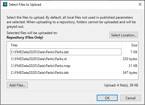

    • Upload data files: If the workspace has file resources that need to be uploaded, check this box. Then, click Select Files to verify the list of files to be uploaded.
    • Select Files: Opens the Select Files to Upload dialog, where you can select from the list of available file resources that need to be uploaded with the workspace.
    • Note  For information about uploading shared resources, including custom formats, custom transformers, and custom coordinates systems, see Sharing Custom Formats, Transformers, and Coordinate Systems on FME Flow.
      The file path indicates where any resources currently reside in your local folder. In this example, FME Workbench has identified four resources associated with the workspace:
      To add or remove files and folders from being uploaded, check or clear their respective check boxes. To add more files, click Add Files.
      At the top of the dialog is indicated where the files are uploaded in FME Flow. In this example, the files are uploaded to Repository, which means the repository specified in the Publish to FME Flow dialog.
      Click OK to close the Select Files to Upload dialog.
