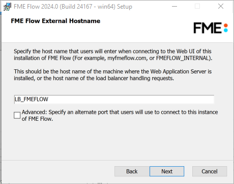

FME Flow External Hostname
If this FME Flow installation will be available to users outside an internal network (for example, on an external website), specify the external hostname that users will enter when connecting to FME Flow. For example, if you are hosting FME Flow on myfmeflow.com/myfmeflow, enter myfmeflow.com.
Otherwise, enter the internal server hostname, IP Address, or DNS.
If a load balancer or reverse proxy is deployed through which to access FME Flow, check Advanced and provide the External Web Traffic Port. Specify this port only if it differs from the Web Application Server Port (below).

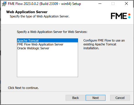

Choose a Web Application Server:
This selection is valid if you have already completed the step to Provide a Web Application Server.

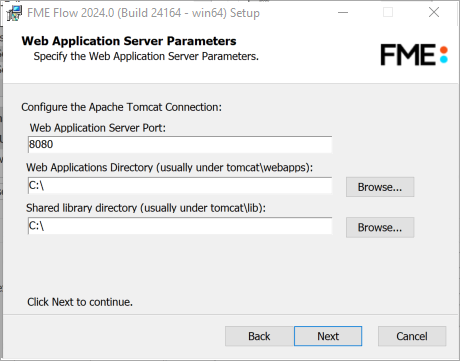

Web Application Server Parameters
Specify the connection parameters for the web application server.
The Web Application Server Port should be the same as the one that was specified when Apache Tomcat was installed. The default Apache Tomcat port is 8080.
The Web Applications Directory and Shared library directory can be found in the webapps and lib folder, respectively, under <ApacheTomcatInstallDir>/tomcat/.
