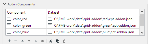

Addon Components
Addons are datasets containing additional components that can be added to an existing EPT dataset in order to add or change values, without rewriting the entire dataset. These can be created by the Point Data Abstraction Library (PDAL).
This parameter specifies the addon components to read, and the corresponding ept-addon.json datasets for those components. Note that the reader dataset is an ept.json file, and each addon component dataset is a separate ept-addon.json file. These are not interchangeable (that is, a reader dataset can't be used as an addon dataset, and an addon dataset can't be used as a reader dataset). Each addon component dataset resides in a separate folder, and each ept-addon.json file must be explicitly selected. For example:
Screenshot showing R,G,B ept-addon.json components
