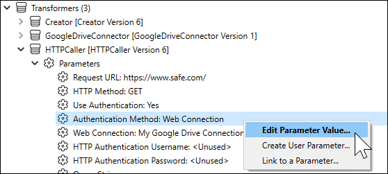

Reusing a Web Connection
After you create a connection, it is available for you to reuse along with any others you have created:
