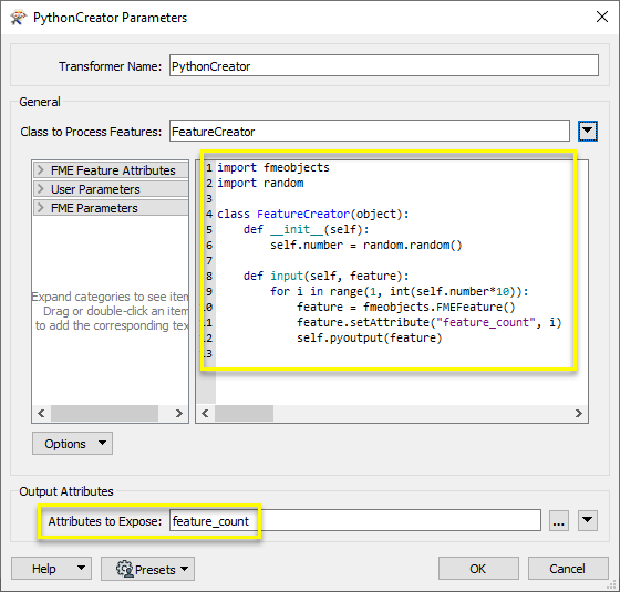

Example Class
The example below creates a random number of features, between 0 and 9.
