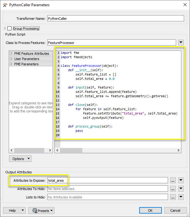

This is the operation mode when no attributes are set in the Group By parameter. In this mode, which is the most common, the PythonCaller will have the following calling sequence on a class:
- __init__() - Called once, whether or not any features are processed.
- input() - Called for each FMEFeature that comes into the input port.
- close() - Called once, after all features are processed (when no more FMEFeatures remain). If no features are processed, the close() method will still be called.
Features that need to continue through the workspace for further processing must be explicitly written out using the pyoutput() method.
When the class interface is processing incoming FMEFeatures one at a time, the pyoutput() method is to be called once per incoming FMEFeature in the input() method. Conversely, when the class interface is operating on a group of FMEFeatures, the incoming FMEFeatures can be stored in a list, then processed and written out through pyoutput() in the close() method.
The example below calculates the total area of all the features processed and then outputs all the features with a new attribute containing the total area:

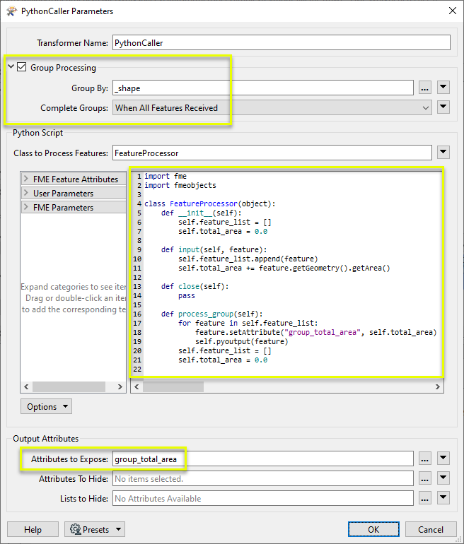

Complete Groups
This is the operation mode when one or more attributes are set in the Group By parameter. In this mode, the PythonCaller will have the following calling sequence on a class:
- input() - Called for each FMEFeature in a group.
- process_group() - Called after all FMEFeatures in a group have been sent to input(). After this is called and executed, PythonCaller will send the next group of FMEFeatures to input() and then call process_group() again. This is repeated until all groups have been exhausted.
- close() - Called once, after all rounds of input() and process_group() have been called to process all incoming features (when no more FMEFeatures remain). If no features are processed, the close() method will still be called.
In this mode, the class interface will be working on groups of FMEFeatures. The incoming FMEFeatures must be stored in a list class member variable, then processed and written out through pyoutput() in the process_group() method. After processing is complete in process_group(), all class member variables should be cleared for the next round of group by handling. In the next round, FMEFeatures of the next group are passed through input() calls followed again by process_group(). This is repeated until all the groups are exhausted.
The example below calculates the total area of all features grouped by the _shape attribute and then outputs all the features with a new attribute containing the total area for each group:
