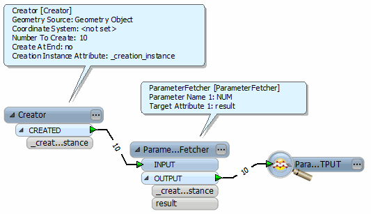

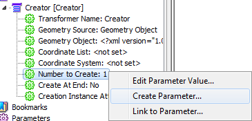

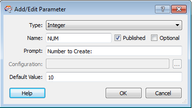

The Creator transformer shown below has a published parameter called NUM. To publish this parameter, place the Creator transformer in the workspace. Then right-click on Number to Create and select Create Parameter.
The dialog shows the Published Parameter properties, with the default value changed to 10:

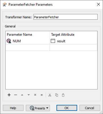

Choose the NUM parameter in the Parameter Name field, and type a Target Attributeresult.

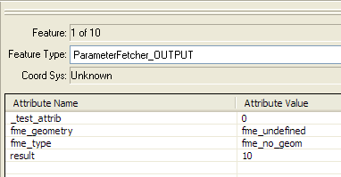

When the workspace is run, the ParameterFetcher fetches the value assigned to the "NUM" parameter and stores it in the "result" attribute. Now the feature has an attribute "result" which holds the value of the "NUM" parameter.
You can see the attribute and its value in the FME Data Inspector.

Parameter Name |
When the ParameterFetcher is connected, the Parameter Name drop-down list shows the parameters that can be fetched from the workspace. The Parameter Name also exposes FME Parameters and FME Server Parameters. |
Target Attribute |
The target attribute is the name of the attribute that will be created. When you select a parameter, this field is automatically filled with an appropriate name (for example, selecting a parameter named WIDTH will automatically name the target attribute _WIDTH). You can use the default name, or type a new name. |
