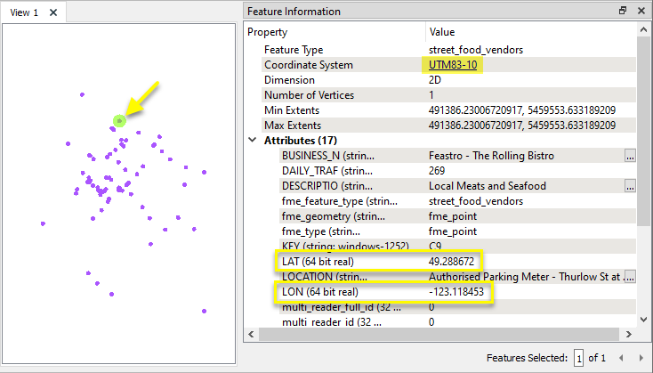

In this example, we have a shapefile of food vendor locations, and want to generate MGRS codes for each location.
Note that although the dataset is in a UTM coordinate system with ground units in meters, it also has a set of coordinates, latitude and longitude, stored as attributes.

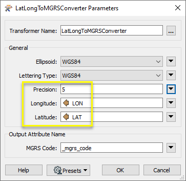

In the parameters dialog, Precision is set to 5, and the Longitude and Latitude parameters are set to the appropriate attributes.

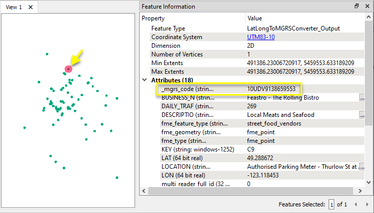

The output features have a new attribute containing the resulting code.
