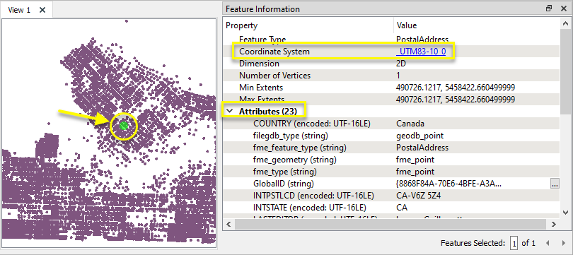

In this example, we have a geodatabase containing address points. Note that the point features have 23 attributes, and are in a UTM coordinate system. We want to extract the coordinates of each point into attributes for use elsewhere.

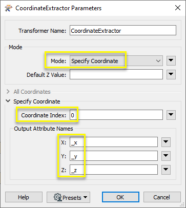

In the parameters dialog, Mode is set to Specify Coordinate. The Coordinate Index default is zero (0), the first one, which is correct. Default names are also provided for the X, Y, and Z output attributes.

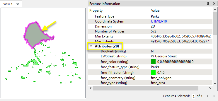

In this example, we have a set of park polygons, and want to retrieve all of the coordinates for them. Note that the input features have 28 attributes.

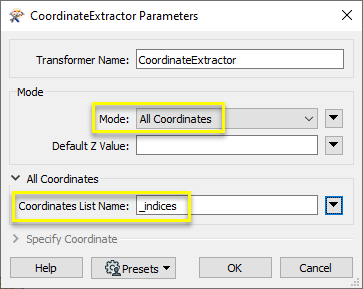

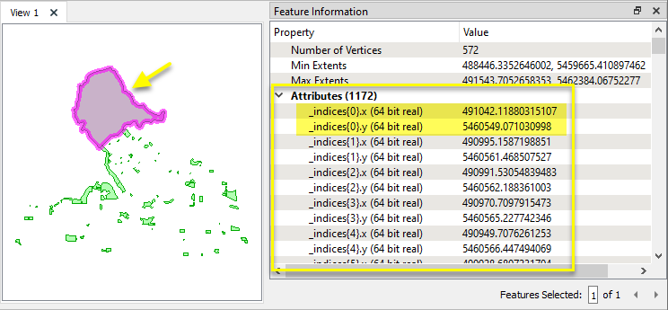

In the parameters dialog, Mode is set to All Coordinates. A default name is provided for the Coordinates List Name - _indices.
The output features have an added list attribute named _indices containing coordinates for each vertex of the polygon.
Note that each coordinate has an x and y value only. Z was not added as the data is 2D and we did not provide a Default Z Value.

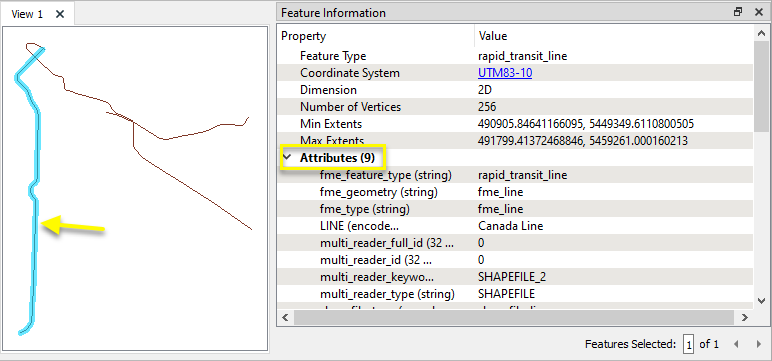

In this example, we want to retrieve the coordinates of the first and last points of these transit lines. Note that the original features have nine attributes.

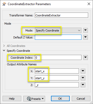

In the parameters dialog of the first CoordinateExtractor, Mode is set to Specify Coordinate and Coordinate Index is set to zero (0), indicating the first vertex.
The X and Y Attribute names are edited to start_x and start_y.

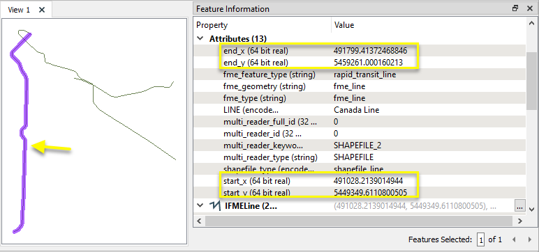

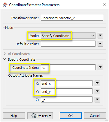

Similarly, in the parameters dialog of the second CoordinateExtractor, Coordinate Index is set to -1, indicating the last vertex. X and Y Attribute are set as end_x and end_y.
The output features have added attributes containing the requested coordinate values.
