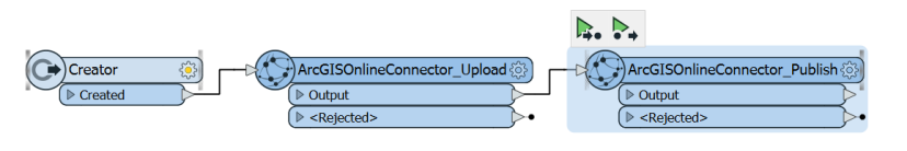

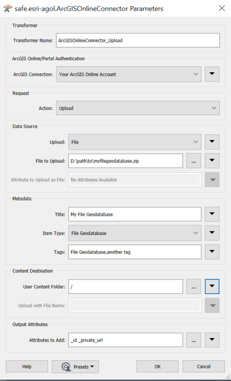

In this example, the ArcGISOnlineConnector is used to upload an Esri File Geodatabase from the user’s local files and publish it as a hosted feature layer.
The user can select the file geodatabase on their local system using the file picker in the ‘file to upload’ parameter. After creating a valid web connection to an ArcGIS Online account (which can be done in the ArcGIS Connection parameter), the user can specify the ArcGIS Online folder to upload the file to, as well as the title and tags to upload the item with.

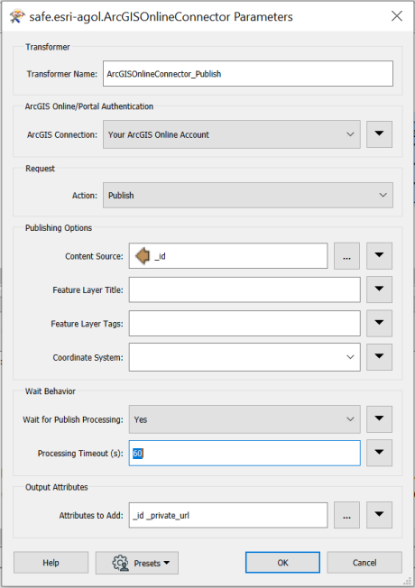

After the file geodatabase has been successfully uploaded, you can use another ArcGISOnlineConnector to publish the newly created item. To keep the title and tags of the item you just created, you can leave those fields blank. You can also choose to wait for publish processing. This will wait for the specified amount of time while your new feature service processes.
You can also choose to use another ArcGISOnline connector to share the newly created feature service/uploaded item. By default, items will only be visible to yourself.

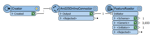

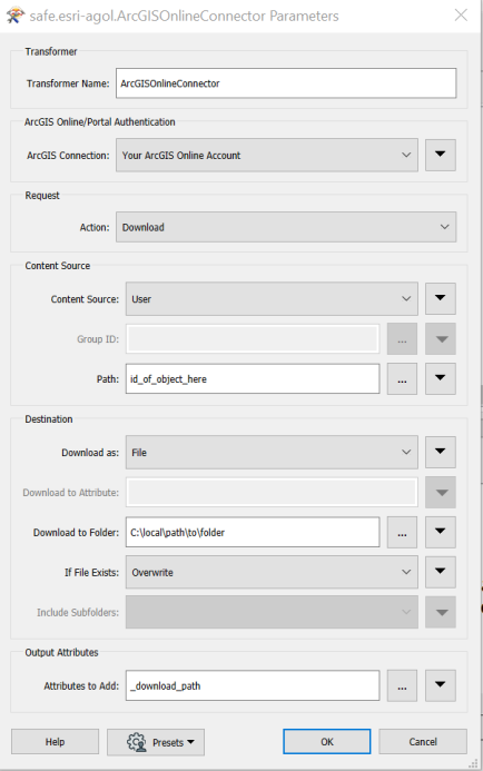

In this example, the ArcGISOnlineConnector is used to download an Esri Shapefile from the user’s ArcGIS Online Content. After creating a valid web connection to an ArcGIS Online account (which can be done in the ArcGIS Connection parameter), the user can browse their ArcGIS Online content and select their shapefile. They can also select a destination for the download.
A FeatureReader is added to read the newly downloaded dataset. The data from the downloaded shapefile is now available to use elsewhere in the workspace.

Download a file/folder to an attribute/file/folder from a user’s ArcGIS content or a group they have access to.
Content Source
Content Source |
Select the source type of the content to be downloaded
Group ID |
The ArcGIS group which the content is linked to. Note:
Path |
The ArcGIS Item ID of a file or folder to download. If valid credentials have been provided as a web connection, you may browse to a location. Depending on the value of the Content Source parameter, this will list either the contents of the specified group or the user’s own ArcGIS content. Only items which can be downloaded will be displayed. If the user has permission to access items stored in other locations, the id of those items can be manually entered in this field. |
Destination
| Download as |
Select whether to store the downloaded data in a File, Folder or Attribute.
| Download to Attribute |
Specify the attribute that will store the contents of the downloaded file. Valid for Download as Attribute only. Note: FME will attempt to convert the attribute's contents to a UTF-8 string. If this fails, the attribute's contents will be created as raw binary. To ensure that the original bytes are always preserved and never converted to UTF-8, use Download as File instead. |
| Download to Folder | Specify the path to the folder that will store the downloaded file. Valid for Download as File or Folder. |
| If File Exists | Whether to overwrite existing files in the target destination. Valid for Download as File or Folder. |
| Include Subfolders | Whether to include subfolders when downloading a folder. Due to the way that ArcGIS content is structured, only the root folder contains subfolders. Valid for Download as Folder |
Output Attributes
| _download_path | Return the path the file/folder was downloaded to. If a folder was downloaded, the path will have a trailing slash. |

Publishing Options
Content Source |
The Item ID of a stored ArcGIS file to publish. If valid credentials have been provided as a web connection, you may browse to a location in the user’s content. Only publishable items should be displayed in the browser. The user must be the owner of this item. Note:
Feature Layer Title |
The name to set for the newly created feature layer in ArcGIS. If this is left blank, the published item will use the existing title of the source item. Note:
Feature Layer Tags |
The tags that the published feature layer should have in ArcGIS. If this is left blank, it published item will have the existing tags of the source item. |
Coordinate System |
Specify the target spatial reference of the created feature service. If not specified, this will default to WKID 102100. |
Wait Behavior
Wait for Publish Processing |
Whether to wait for the feature service created to publish
Processing Timeout (s) |
The amount of time (seconds) to wait for the feature layer to publish. If not specified, this will default to 180 seconds. |
Output Attributes
_id |
Returns the ID of the feature service which was just created. |
_private_url |
Returns the link to the ArcGIS Online web content page for the newly created feature service |
_service_type |
Returns the type of service created with the publish operation |
_webservice_url |
Returns the URL which the newly created feature service can be accessed at. Only valid for feature-service like ArcGIS Online items. |

Upload a file or attribute to a location in a user’s ArcGIS Content
Data Source
Upload |
The type of data to be uploaded.
When working with large objects, File is a better choice than Attribute as the data will be streamed directly from disk and not require that the object be stored entirely in memory on a feature. |
File to Upload |
The file to be uploaded to an ArcGIS account. Valid if Uploading from File. |
Attribute to Upload as File |
The attribute to upload data from. Valid if Uploading from Attribute. |
Metadata
Title |
The name to set for the uploaded item. |
Item Type |
The ArcGIS item type that the uploaded file should have. Notes:
Tags |
Specify tags for the created item. Tags should be provided as a comma separated list. |
Content Destination
| User Content Folder |
The ArcGIS folder ID to upload to. The name of a user’s ArcGIS Folder can also be used, provided that it does not conflict with the ID of an existing folder. If no such folder exists, one with that name will be created. If valid credentials have been provided as a web connection, you may browse to a location in the user’s content. Only folders may be selected. Note:
| Upload with File Name | The name of the file created from the data supplied in Attribute to Upload as File. The name must include a filename extension (for example, .csv, .jpg, .zip). |
Output Attributes
| _id | Returns the ID of the target item which was just created. |
| _private_url | Returns the link to the ArcGIS web content page for the updated item. |
