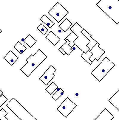

The two source datasets look like this:

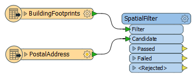

The address points – the dataset to be tested – are connected to the Candidate input port. The building footprints are connected to the Filter port, and provide the geometry that the address points will be tested against.

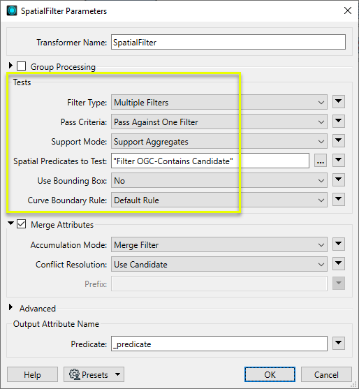

In the SpatialFilter parameters dialog, we make the following selections:
- Filter Type: Multiple Filters. There are multiple building polygons that we want to test against.
- Pass Criteria: Pass Against One Filter. Each address point only needs to fall inside one polygon – not all of them.
- Spatial Predicates to Test: Filter OGC-Contains Candidate. We want to check if each Candidate (address point) falls within a filter (building polygon).
These are the key parameters – the others are left as default for this example.

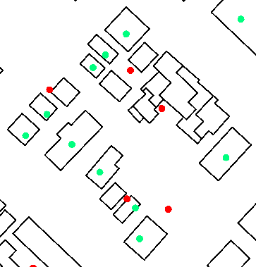

Address points that pass the test – that are within a polygon – are sent out through the Passed port, and have a new attribute called _predicate, set to “CONTAINS”.
Address points that fail the test – that are outside all polygons – are sent out through the Failed port. The results, with styling applied in the FME Data Inspector, look like this:
