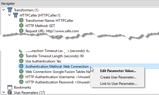

Many processes in FME Form require you to connect and authenticate to a web service in order to use them. For example, when you use an HTTPCaller transformer, you may need to authenticate to a web service, such as Google BigQuery. Similarly, if you want to connect to an FME Flow, you must specify a set of connection parameters. Web connections provide a convenient and secure way to store and reuse these connection parameters. Each time you need to specify the same connection parameters, you can use the connection, rather than re-entering the parameters. If the connection parameters change, you can edit them in one place, rather than in each workspace that uses the connection.

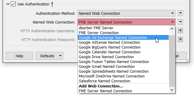

You can use an existing web connection, or define a new one, in a Transformer Parameters, Add Reader, or Add Writer dialog.
Visibility: This field applies only if Connection Storage, as specified in Tools > FME Options > Default Paths, is a shared location visible to multiple users. Specify whether the connection is available only to yourself, or to any user of the database (Public). For more information, click Help from the Default Paths window under Tools > FME Options.

To create a new connection in a transformer, such as FME FlowJobSubmitter, and use it right away, select Add Web Connection.
