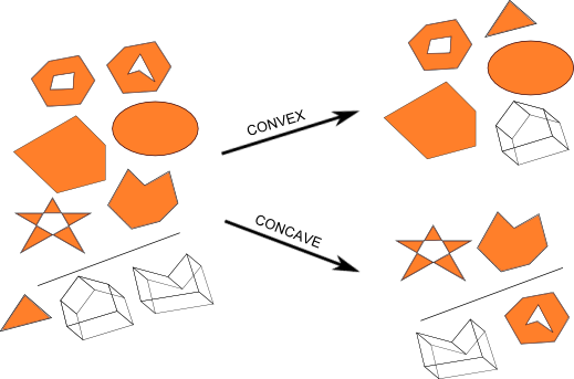

This diagram shows both convex and concave examples.

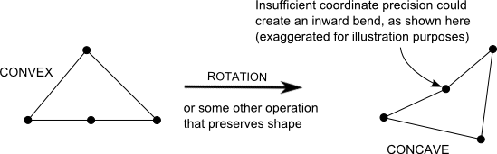

- The test is limited by the precision of the geometry’s coordinates – be careful of “invisible” bends in lines, as shown here:
