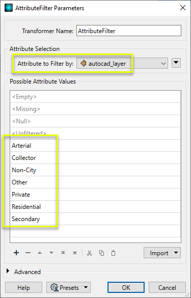

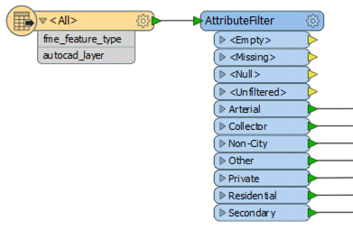

In this beginning of a workspace, a CAD file containing road data is read, and the features divided into separate streams for further processing based on the autocad_layer attribute value.
The transformer has been connected to the incoming features from the Reader, and so the dataset’s attributes are available for selection. The autocad_layer attribute is chosen.
The desired values are entered, each on a separate row. The available values could also be determined by using the Import button to scan the contents of the dataset.

For each value entered in the Possible Attribute Values list, an output port is created with the same name as the value.
Attribute to Filter by |
When you connect the transformer to the feature type, the list of attributes will appear in a pull-down list. Choose the attribute from the list. |
If you know the values you wish to filter, enter them individually here, one per row. Each entry will create an output port.
You may also import values from a source dataset by using the Import button.
