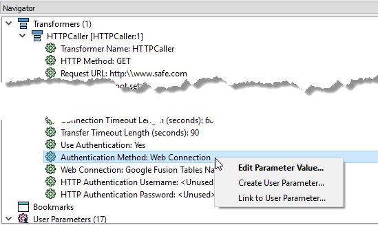

When you use a web connection in a workspace, the Navigator displays only the connection name. The service name, username, password, and other connection parameters do not display. For example, here is how connection information displays in the parameters of a transformer that uses a web connection.
Additionally, all web connections in the workspace are listed under Web Connections.

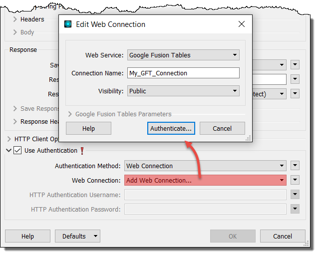

You can use an existing web connection, or define a new one, in a Transformer Parameters, Add Reader, or Add Writer dialog.

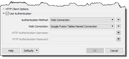

For example, in an HTTPCaller transformer parameters dialog, check Use Authentication. In the Authentication Method field, specify Web Connection. In the Web Connection field, specify the connection.
Alternatively, to create a new connection and use it right away, in the Web Connection field, specify Add Web Connection.
In the Edit Web Connection dialog, specify the web service, a name for the connection, and the connection parameters.
WARNING: For production purposes, we recommend specifying user-defined web services, rather than the pre-registered services already provided. For more information, see Managing Web Services.
If the web service uses the OAuth standard, click Authenticate and validate your connection directly with the web service.
Visibility: This field applies only if Connection Storage, as specified in Tools > FME Options > Default Paths, is a shared location visible to multiple users. Specify whether the connection is available only to yourself, or to any user of the database (Public). For more information, click Help from the Default Paths window under Tools > FME Options.
Note: The following characters are not allowed in connection names: ^ \ / : * ? " < > | & = ' + % #
For more information, see the applicable topic in the FME Transformers or FME Readers and Writers Help.

To Change a Web Connection in a Workspace
You can change an existing web connection in the following ways:
- Change the connection parameters.
- Change a web connection to one that exposes the connection parameters in the workspace.
- Change a connection whose parameters are exposed in the workspace to a web connection.
In the Navigator, right click on the Authentication Method parameter of the applicable object, such as a transformer, that is using the connection, and select a desired method for editing the authentication parameter.
