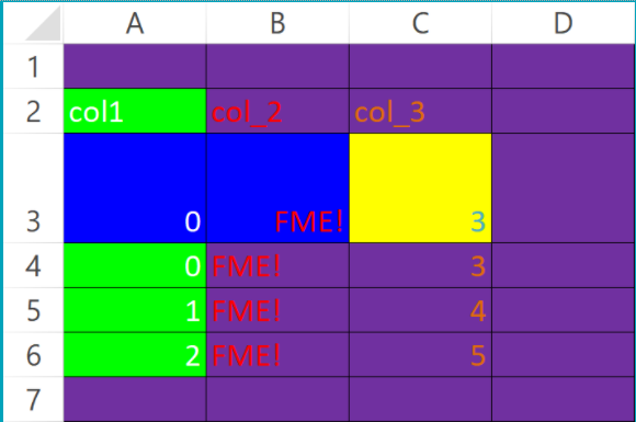

Note
Formatting is applied with the order of precedence: template < column < row < cell. That is, cell formatting will overwrite row formatting, column formatting, and any formatting set on the template sheet. Row formatting will override formatting set by the column and formatting set on the template sheet. Column formatting will only override formatting set on the template sheet.
For example, in the image below, the background color is used to exhibit the order of precedence for formatting, the yellow background of the cell is overriding the blue background of the row (cell C3), which in turn is overriding the green background of the first column (cells A3,B3), which is overriding the purple green background of the template (cells A3,B3).
Similarly, the text color or font_color is used to exhibit how default values are used when higher precedence formatting is not specified. In the image below, the font_color on the row is not specified, so the default color from the template is used, as well as the font_color set in the second column (white in cell A3 and red in cell B3). The font_color of the cell is set, so it overwrites the column’s font_color (blue in cell C3).
