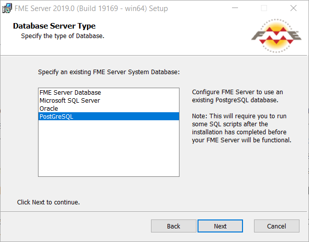

Database Server Type
Specify the type of database for the FME Server Database. If you installed the PostgreSQL database included with the FME Server installer, select FME Server Database. If you are configuring the FME Server Database on your own database server, select the database server type: Microsoft SQL Server, Oracle, or PostgreSQL. For more information, see Provide a Database Server.
