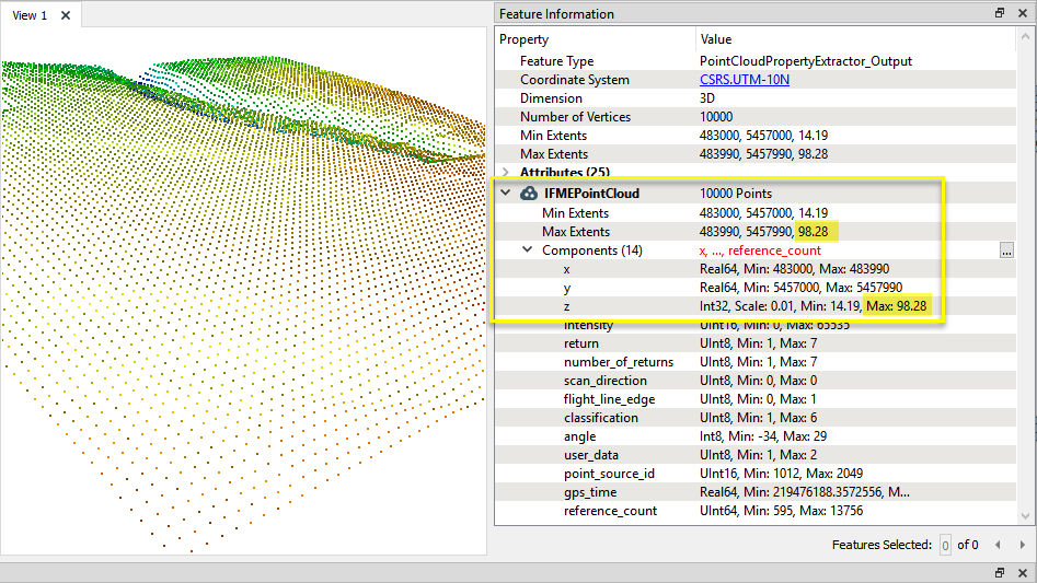

After sending the Referenced point cloud through a PointCloudPropertyExtractor (not shown in the workspace above) to calculate its new x, y, and z extents, we can see the bare earth representation as points spaced 10 meters apart, and with a new maximum elevation of 98.28 meters.
