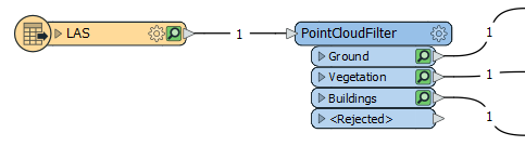

The point cloud is routed into a PointCloudFilter.

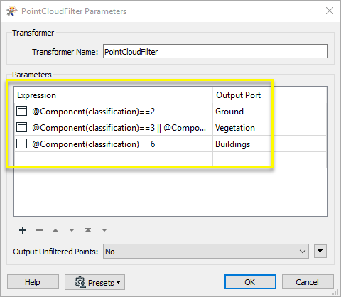

In the parameters dialog, we create three expressions based on the classification component values.
Note that the Vegetation expression is more complex, looking for any one of three possible values (|| means “OR”).

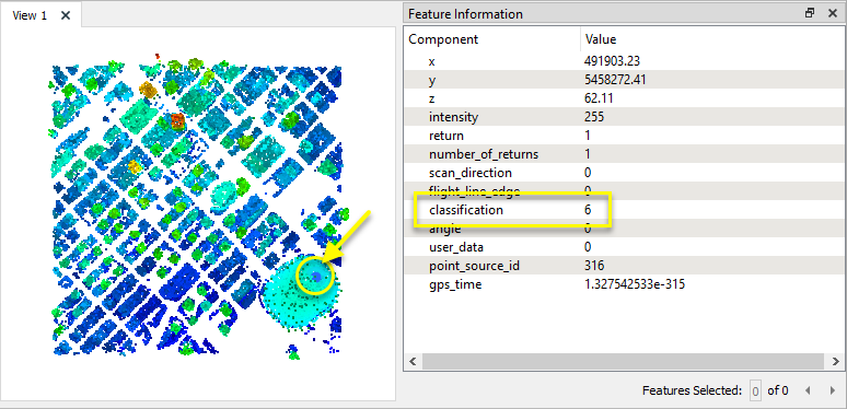

Examining the output of the Buildings expression in the FME Data Inspector, we can see that this particular output feature contains only the points with a classification value of six, which are the buildings.

For each expression entered in the Expression table, a corresponding Output Port is named and created.
If Output Unfiltered Points is Yes, points that do not match any of the specified expressions are output via the <Unfiltered> port.
