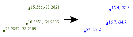

For arcs, only the start and end points are rounded, as these are the only coordinates which lie on the path of the arc. The center point is not rounded, nor are any other of the arc's parameters.
This transformer may be used to remove superfluous decimal points in the coordinates when they are destined for an ASCII output file.
CoordinateRounder may not always behave as some might expect due to limitations in floating point processing. Some numbers like 1.1 cannot be stored precisely in binary and so end up as 1.1000000000000001, regardless of rounding. Rounding to 3 decimal places, results in 1.1000000000000001. Similarly, a value of 3.3333 is stored as 3.3332999999999999, and when rounded to 2 decimal places ends up as 3.3300000000000002.
Note that you won't always see the same effect in the AttributeRounder since some attributes may treat numeric values as strings until the are evaluated in a formula or written out. So, the AttributeRounder may appear to round to 3.33. Still, when the value is actually used, the processor will end up using a value of 3.3300000000000002. On the other hand, coordinates in FME are typically logged with full floating point precision, including any floating point processing precision error. Note that many formats have a way of controlling decimal precision based on data types or precision as set on the writer.
The precision values control the number of decimal places that the coordinates are rounded to. A value of 0 causes the coordinates to be rounded to the nearest integer. A value of 1 causes rounding to the nearest tenth of a unit. Negative values are allowed. A value of -1 causes rounding to the nearest 10.
