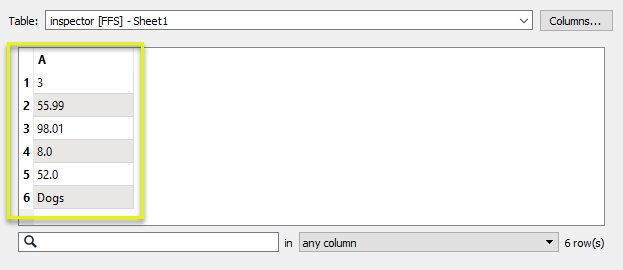

In this example, a spreadsheet containing values will be rounded to 2 decimal places. The source data is not clean, containing one alphanumeric string mixed in with an assortment of numbers.

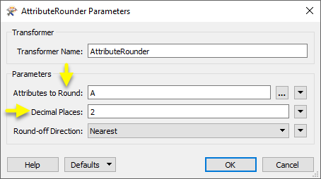

In the parameters dialog, we select attribute A for rounding (column A from the spreadsheet), and set the number of Decimal Places to 2. The Round-off Direction is left as Nearest, which rounds up or down as appropriate.

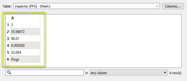

The values are rounded where possible, and replace the original attribute values. Note that numbers that had less than 2 decimal places to start with are not zero-padded, and the non-numeric string “Dogs” has been passed through unaltered.
